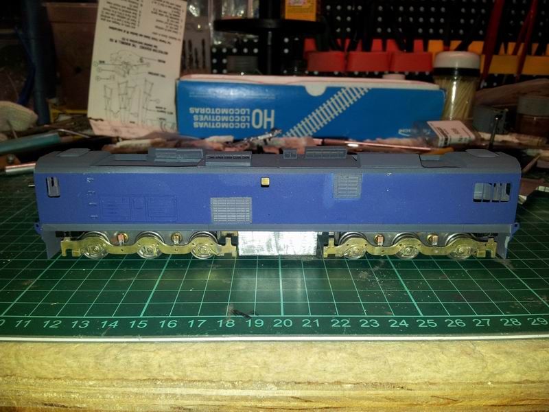

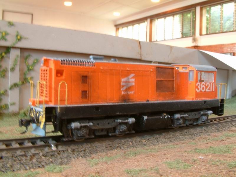

I started scratch building many years ago.  I mainly work in styrene and 2 part resins.  one of the first scratch built items I did was a SPOORNET class 36-200 diesel shunter.  this was before the Penning resin kit was available...
The model is is a kitbatsh of a bluebox athearn SW1500.  I only used the long hood to cut up for top, front and side details.  the cab is a casting taken from a lima class 34, and the chassis is the SW1500...

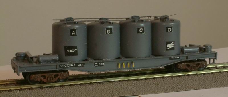

up next... i like the South african hoppers and cement wagons...  so I scratch built this broken banana tanker using a fax paper roll, and styrene for the other parts. ass well as some brass and wire...

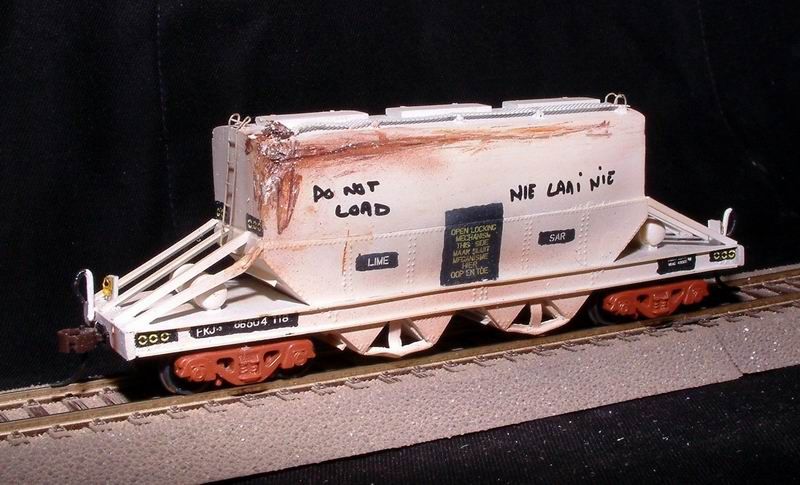

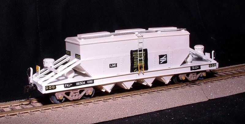

I built the lime hoppers from styrene, and made molds, from which the following are cast and built.
The lettering was custom done by CMD models

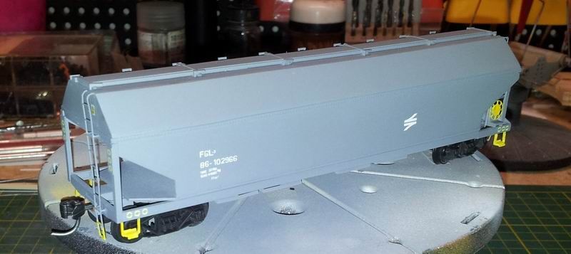

This is the most recent scratch built item... the jumbo grain hoppers...  this is 100% scratch built from diagrams and photos...

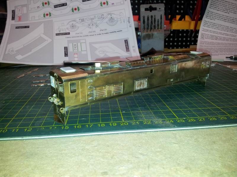

I am busy finishing the CMD models brass 10E1 loco... still a big of work left...

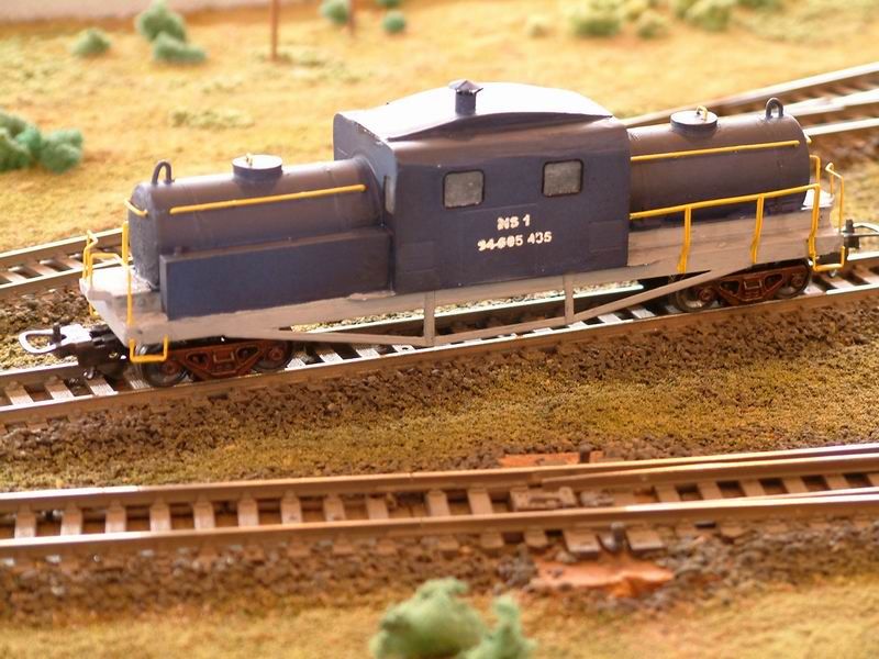

the following steam car was scratch built from drawings and photos.  I used brass for the cab, chassis and hand rails.  Styrene was used for the roof and tanks.

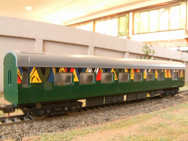

and last, but not least for the SAR/SPOORNET, I repainted a Lima dinig car in BJ's colours.   this is all hand painted, no decals...

Love that brass 10E1.

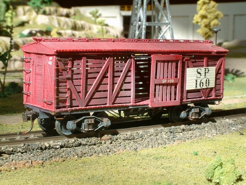

I built this Southern Pacific Stock Car from drawings publish in Narrow Gauge Gazette.  The model was built in styrene. the sides and frame was constructed board by board. The floor and roof are scribed sheet styrene.   The truss rods are brass, and bogies/couplers are Kadee metal products.  The doors can open and close, and they slide on rails made from brass rod. this was one of the last models I painted with enamel paints.  I switched to acrylics completely.  Ok, not completelely.. I love Model Master Metalizer paint to create metal effects...   but I am going off topic...
by the way, this was also the 1st model I ever dared to weather...  did not go too bad, I think... lol

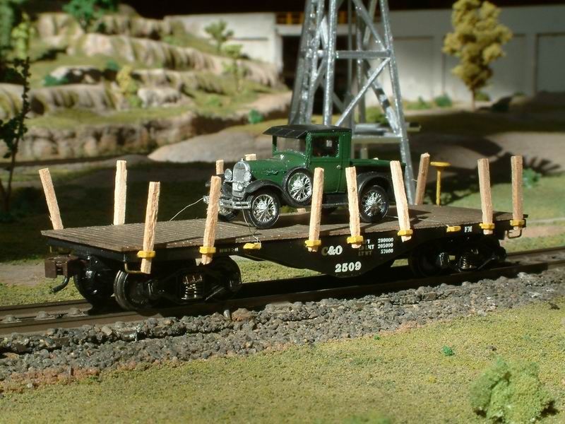

the next model is a brass and wood model I also scratch built from plans in narrow gauge gazette.  it is supposed to be of a logging railroad prototype... but I decided it will be C & O...  brass frame, real wood deck and stakes.  The ford pickup is a plastic kit I built, not sure of the maker.  All I can remember is that the kit came in a small white box with a sticker printed with the details of the model.
again, kadee couplers and metal bogies and wheels was fitted

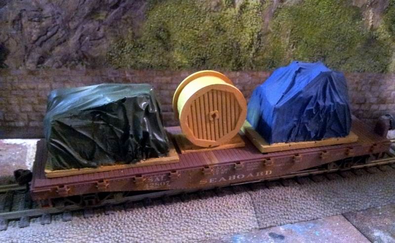

The next model is an athearn blue box flat car.  I only fitted the load, and applied some weathering, replaced wheels with metal and added kadee #5 couplers.  quick, fun, saturday afternoon project...  this is one of the models I run at the GFG meetings.
This model is no longer in my collection, I swopped it for 2 other cars...  It is still used at GFG meetups, so I do get to see it occasionally...   very little done here...  again, metal wheels and kadee #5 fitted.  I built the load with twigs collected from my back yard, and cut to size.
a Light dusting of road dirt, grime and dust, and a little rust here and there finished this model off.   I am a big fan of weathering rolling stock and locomotives.  when done in moderation, i think it adds so much, visually, to the model.   I do like real rust bucket weathering also, but it should not be done to each car...

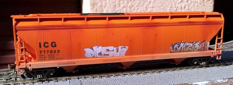

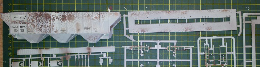

I apologise that I do not have a better shot of the following car.  it is a proto2000 PS2-CD 4200cu.ft. covered hopper kit.  it is factory painted and lettered, but unassembled.  I decided to test a technique I learned to do flaking paint and rust, but did not want to repaint the whole model. so I inverted the process... the results are quite nice, and I am happy with the outcome.   I wanted to represent an old car that changed owners.  it has only the logo and numbers patched and repainted, and the rest of the car left unchanged...
to achieve this, I patched the bits I wanted to KEEP with masking tape.  I then painted the rest of the car in a different shade of gray, and let it dry completely.  the masking stayed in place for the next step.  you need, a soft bristled paint brush, and water with a drop of liquid dishwashing soap, and a mixture of regular table salt and course salt.
using the brush, paint patches of the water mixture.  then apply the salt mixture by sprinkling with your fingers where you DO NOT WANT RUST (this will be most of the model!) make sure you get loose grains in various places to get the spotty rust effect.  leave the model to dry.  when dry, carefully turn the model over, and repeat the process on the other side.  handle the model very carefully, as the salt is only very very delicately sticking to the model.  again, let it dry.  once the whole model is covered in salt, and it is dry, it is time to move on.   use a flat dark brown or slightly reddish brown paint and cover the model where you want rust (this should be in places with no, or scattered or very little salt.  apply the paint very lightly and with low air pressure to not blow off the salt.  when done, let it dry.  (this is one of the reasons I switched to acrylics... drying times are a few minutes!!!)
when your paint is dry, use a stiff bristled brush, and brush off the salt, making sure you get it all.   you should get the kind off effect seen above.   a flat clear coat will finish the model  you can accentuate some of the rust now with some pastel rust streaks and some dust and road grime in the lower parts of the wagon.   depending on cargo, light streaks can also be bade from the loading covers down the sides...

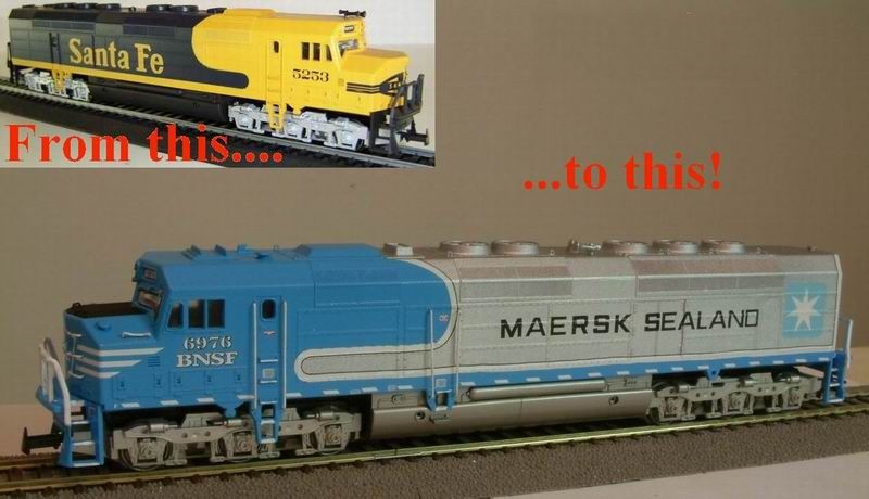

The first item up is a Mehano model that was converted to EMD SDP40-2 BNSF 6976. it is one of 2 locos used by Maersk to promote a new container terminal they built on the 1990s (the other loco was a Norfolk Southern SD40-2).  this model was detailed using etched stainless steel lift rigns, etched brass grilles, and brass rod handrails/grab irons/steps.  I used a microscale decal set for the lettering and graphics. paint is Tamiya acrylics.  the image shows a before and after of the model...

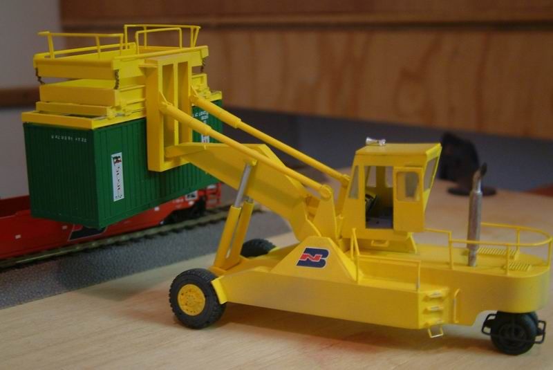

in addition to BN, I am also a great intermodal fan.  I needed some equipment to handle the containers, so in a few moments of dilerium, I decided to scratch build a container crane.  I chose the Mi-lift Piggy Packer...  some photos and drawings off the interwebby thingie got me going...  and ended in the model below...
this packer is built from styrene.  for the front wheels, I used casting I made from a 1/35th scale model of a Ratel infantry vehicle, and for the rear wheels I used Herpa truck wheels.  the boom is fully positionable, and can be lifted and lowered as needed.  the jib can not adjust, and is built for 20' containers.  they jib clips tightly into Walthers 20' container's holes.
BN decals and some dst and dirt finished this model.

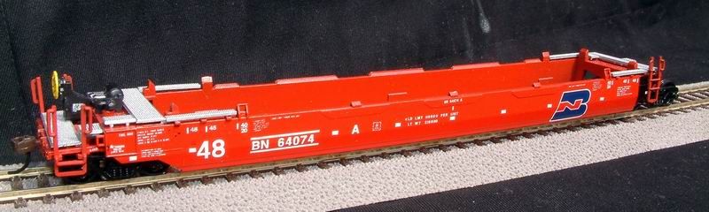

still on the intermodal theme, I purchased 3 Athearn bluebox 5-car double stack car sets.  It goes without saying that BN had to feature somewher. so the first 5-car set is decalled for BN.  The models are Athearn BB undec.  I assembled, painted and lettered using Microscale decals.   the other 2 sets are yet unbuilt, but 1 will be lettered for Trailer Train, and the 3rd one will be Maersk.  this is just 1 car from the 5-car set...

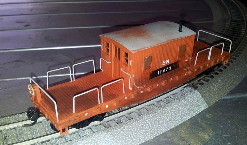

if you thought an 'aap kas' was a south african idea, think again.  transfer caboose are used in places where trains needed to be moved within yard limits. they should never go on the main line.   transfer caboose are built with whatever is available at the shops.  here I modelled an BN (ex GN) transfer caboose.  it should be running on ALCO diesel loco bogies, but I substituted normal roller bearing bogies... painting, weathering, metal wheels and kadee #5 couplers, and wire handrails.  the cabin and flat car is from a kitbashed athearn bluebox model.

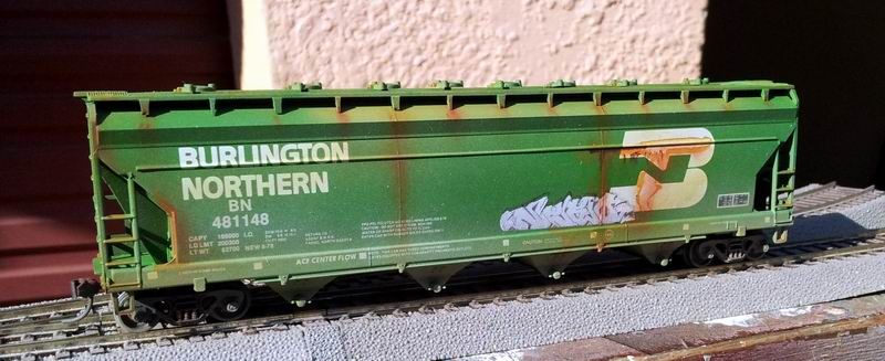

yet another Athearn bluebox kit... BN 481148 covered hopper.   by now standard practice... plastic wheels out, metal wheels in. Kadee #5 couplers on.  weathering using the pastels and acrylic paints, and graffitti decals.  this is one of... no, wait... this is my favorite model right now...

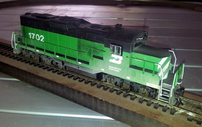

not to be left out, the Walthers Trainline EMD GP9m was shipped in BN green, but the paint scheme was never applied to GP9m locos.  I changed it from 'white face' to the zebra stripes, and changed to the number to 1702.  cab roof details were changed to more accurately resemble the real 1702.  still waiting on the workbench to be applied, is a snow plow, and rotary beacon on the roof...

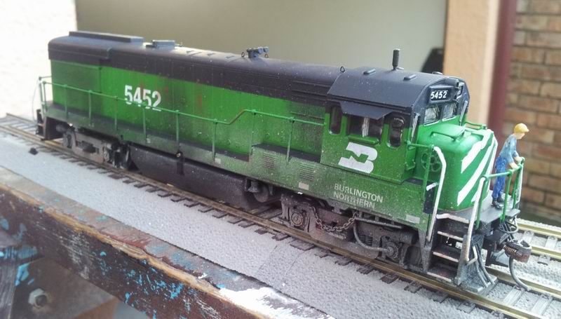

the following is... surprise surprise... Athearn bluebox GE U28B loco. it was also factory painted in BN glacier green and black.  I installed a DCC decoder, and detailed the model.  added safety chains and speed recorder to the front bogie, lift rings to the long hood. I added a fire cracker radio antenna and vents to the roof. the cab is also fitted with etched stainless steel wipers. I fitted MU hoses to the front and rear cow catchers. then I shaved the cast on grab irons off, and replaced with brass wire. finally the number was changed to actual U28B #5452 and weathering was applied...  when I get round to it, a rotary beacon must be added to the cab roof...

Francois youve been a very busy man. The results are fantastic.
Nice scratchbuild on the container lift.
