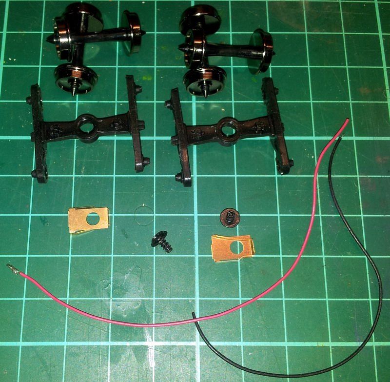

1) Parts needed:
your model might already have some of these items, others you will need to source.  I have not added cost, since prices will vary, and in a couple years' time will be 100% incorrect...   but still, this conversion will cost you very little... look at the parts list...  this is for EACH BOGIE, ie, you need to double this up if you want to convert both bogies on a car...
~2x short pieces of thin, flexible wire (color is irrelevant, but red and black is the standard for DC and DCC)
~2x small self tapping screws (1mm x 3mm is ideal)
~2x Kadee coupler centring springs
~2x insulated axles with METAL wheels (plastic wheels are not good conductors of electricity, so make for VERY BAD power pickup!!!!  :stir: )
~1x your model's old bogie frames

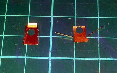

2) Making the power collectors
The Kadee springs needs to have the 'fingers' bent open, and straightened out, and the end needs to be cut shorter.  the actual length depends on YOUR bogies. but in my case, I needed to cut them right next to the hole...
below is the springs, on the left, standard spring, and on the right the modified one...

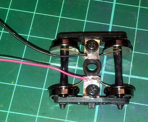

3) Fitting it all together...
The next step for me is to put a small drop of flux on the top side of the spring, and solder the red wire to one, and the the black wire to the other...

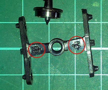

Then, locate the springs on the bogie, and mark the centre of the hole, and drill a small hole (sufficient for the screws to work) on each end of the bolster.  Your bogie might have these 2 little details, as I circled in red below...  Remove them, along with any other details ON TOP of the bolster.  DO NOT REMOVE THE LITTLE LIP AROUND THE HOLE, as this will render the bogie useless!
I found it is easier to FIRST install the wheels, and then fix the springs in place using the 2 screws...

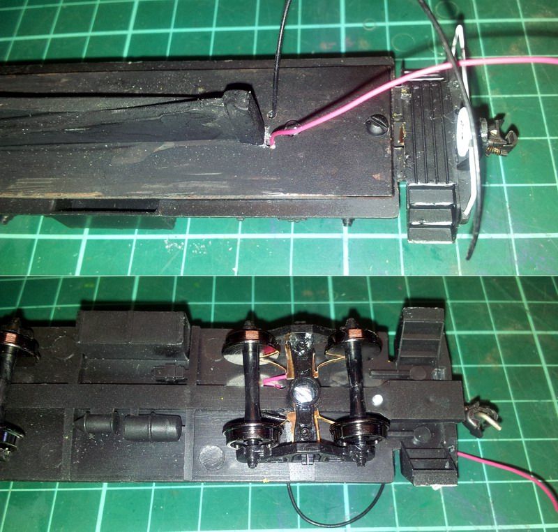

4) Final Assembly
Lastly, drill 2 small holes (bigger than the diameter of your wires) through the floor of the car.  feed the 2 wires through, and fix the bogie using the original screw.  It is important to remember that the bogie must be able to turn unobstructed, so leave a little bit of wire on the OUTSIDE of the car to cater for this!  I usually just leave 2 small loops that I try to get reasonably flat against the floor.
Once done, you will have 2 wires that are on the inside of the car. this can be used to connect to a DCC decoder, or other electronics you might need to have installed.
In order to improve connectivity, and the running of the car, you might need to add some weight to the inside.  They are simply super glued into position.  more weight will ensure all the wheels make better contact, but too much weight will not be good either, so I just stick to NMRA recommended practice. It has served me well up till now...  In the picture above I added 2 large 65mm clout nails to get the total car weight to just over NMRA recommended weight.
